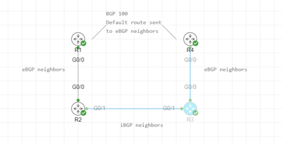

So I had some time to lab it up. Minimal config but same concept. If R1 and R2 are learning the default route from an eBGP neighbor then they will use that respective neighbor for the default route since the AD is 20. The fact that R2 is using R1 for its default route at all suggests that its not getting a default route from its eBGP neighbor. I agree with you higher local preference is preferred but this should not apply if everything is working as it should. Local preference applies to iBGP peers. Which means in order for local preference to take effect you would first have to lose your eBGP peering and your OSPF peering as their ADs both beat out the AD of iBGP. I’m still trying to understand your topology and what is iBGP vs eBGP.
I will say this - as long as you havent manipulated anything the only reason that the router would choose an iBGP peering over OSPF is somehow its not seeing the default route being advertise by OSPF. In my lab everything worked as it should. Both routers chose their respective eBGP neighbor for the default route. Once I killed the eBGP link the OSPF default route took over since its AD is lower.
We are missing something. Can you provide the output to the command I requested earlier of:
sh ip bgp neighbors <eBGP IP> received-routes - on both R1 and R2 of the site thats using iBGP for the default instead of OSPF
Here is my lab:
My R3 is your R2 in this case.
Once I killed the link to R4 and it lost its eBGP neighborship the OSPF default route took over

David, with respect I understand your point but you keep missing R1 and R2 both receive a default, but R1 has added local pref 200 the the default it receives by design. Recalling BGP compares local pref in the path selection process as the 2nd, R2 will choose the path R1 has since it has higher local pref. As far as the topology clarification R1 and R2 are iBGP, the routers with different AS's are eBGP. The default is sent from AS65002 to each hub.
OK I misread your drawing for one of the initial questions I had.
