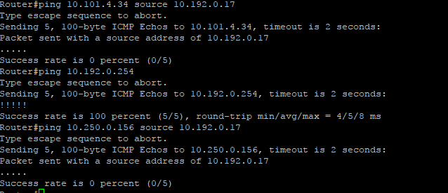

There is nothing wrong with the output of Sh ip nhrp. That is the correct output, as you should see only the Hub address mapped to the NBMA. This is not recursive routing. You can ping any address behind the Hub from the Spoke, with the tunnel IP as the source and see if it goes through the tunnel or not
If you're worried about recursive routing in the future, then put the WAN interface in a VRF and also reference the VRF in the Tunnel interface (Tunnel vrf command) and static default route.
If I may ask, why is your NBMA 1.1.1.237, while the Hub config file shows 1.1.1.2. Was that a typo?
Configure the WAN in a VRF on the spoke? I can ping the tunnel IP but nothing else. There is a typo in the config file....trying to mask the public IP.
