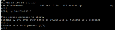

Dear @penguinunix
Was recreating your scenario on a virtual lab. but this diagram is simpler as it does not have yet the secondary ISP connection and with that may try the route-map instead of access-list as suggested by experts.
 So by enabling "debug ip nat" this is what was shown in the logs, the IP address of interface that connects to R2 is being translated.
On this scenario, It was also observed that OSPF neighbor becomes INIT/DROTHER.
In the 2nd line of access list there is a permit ip any
After removing the 2nd line of the access-list, OSPF re-establish. PC1 is now able to reach PC2 and not the networks behind R2.
ping from PC1 to PC2 and to other 192.x.x.x network
Ping from PC2 to PC1
NAT debug output and show ip nat translation in R1
