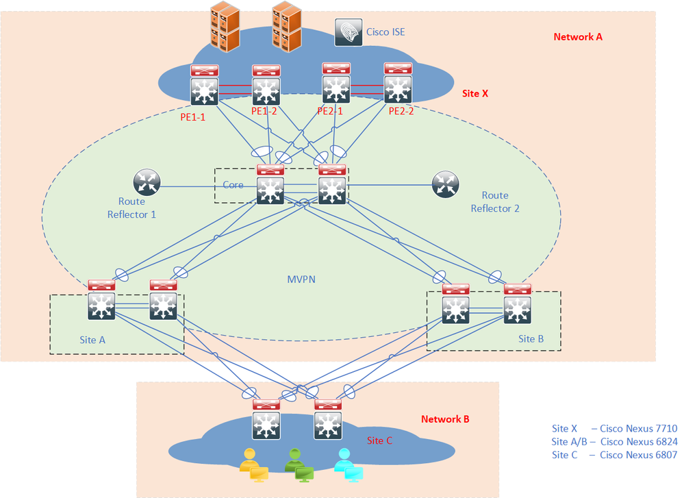

Need help to connect NETWORK A and NETWORK B.
NETWORK A :
1.Endpoints - Total 20,000 endpoints including 12000 cameras and SOC workstations.
2.Cisco ISE 2.4
3.IGMP V2
4.OSPF is used as IGP.
5.iBGP neighborship is formed from all Site A/B & X devices to both Route Reflectors.
6.IGMP V2 for multicast
7.Separate VRFs for different services.
8.SITE A/B Nexus-VSS configured and CORE and PEs NEXUS vPC configured
9.All the endpoints are authenticated with ISE.
NETWORK B :
1.Endpoints - 6000
2.LAN design and setup NO CLUE.
3.Core switches - VSS
Project Requirement :
1.Only SOC team from NETWORK B should be able to access the NETWORK A servers and NETWORK B cameras.
2.NETWORK B workstations should be authenticated with NETWORK A ISE.
3.Connection failure between NETWORK A and NETWORK B should not impact NETWORK B workstations(ISE failure)
EDIT :
I'll try to elaborate the current scenario as much as i can.
Client : Same client but two different teams of Network A and Network B and separate Active Directory domain.
Network Setup :
1.All PE11,PE12,PE21,PE22 have one common ip which is used as an multicast RP by other sites.
2.Firewall cluster is behind all PEs.
3.All camera traffic bypasses the firewall but all other endpoint traffic passes through the firewall including ISE.
4.All the links from sites and PE to core are L3.
Project Phase :
Phase 1 : Connect both SITE A and SITE B to SITE X(we already have other 4 pairs at 4 Sites,similar to SITE A/B requirement)
Phase 2 : Connect Network B to SITE A.Test network reachability and all applications.
Phase 3 : Connect Network B to SITE B.TEST network reachability and all applications.

The devices we are using are mentioned in the right corner of the drawing and all PEs and Site devices are acting as L2/L3 devices.Regarding configs i'm really sorry as i can't share them here in public platform.But i've provided more information in the EDIT section.

Hello Chhabi,
Network Setup :
Project Phase :
1) >> All PE11,PE12,PE21,PE22 have one common ip which is used as an multicast RP by other sites.
Do you mean an anycast RP solution ? You will need MSDP running between these devices to build an anycast RP solution.
What kind of MVPN is implemented ?  the old GRE based draft Rosen (using a GRE encapsulation and global routing tables multicast addresses) or the newer NG MVPN (using mLDP, MP BGP ?).
OK this is normal.
This means the cameras are in a dedicated VRF and they have a direct path that bypasses the FWs ?
it is a combination of MPLS L3 VPN and a form of MVPN so L3 routed links are needed.
