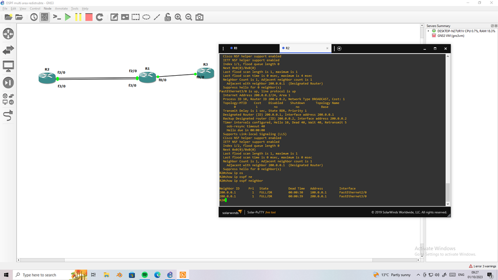

as I mention before but I dont have time to run lab for my answer to be sure.
I get some time to run lab and see result
the R2 have one path to 3.3.3.3 (static route toward R3 in R1) not two path
the key here is forward address of external (static route ).
I think your topology is different from OP (original poster); can u share R1' ouptput of
sh run | s router
and
sh ip os int br
Regards, ML
**Please Rate All Helpful Responses **
Sure I will share all config when I retrun back to home.
