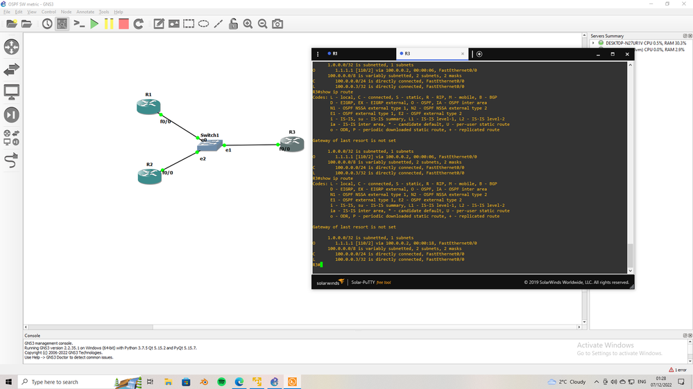

as @Harold Ritter  mention
I change the cost of Lo 1.1.1.1 in R1
and R3 select the low cost toward R2 not R1
