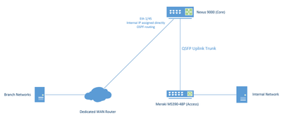

A diagram of this working configuration which I hope is helpful.

At Branch G with the Nexus we are attempting to mirror the setup that works at other branches that have ISRs.
Connection 1 - from WAN handoff device to Meraki access switch (Access Port, VLAN990)
Connection 2 - from Meraki access switch (Access Port, VLAN990) to Cisco ISR
Connection 3 - from Meraki access switch (Trunk port, VLAN1) to Cisco ISR
Connection 4 - from Meraki access switch (Access Port, VLAN990) to SD-WAN device
Connection 5 - from SD-WAN device to Cisco ISR using BGP
This setup works just fine when it is a Cisco ISR.
When we attempt to mirror this when it's the Nexus instead of an ISR, everything goes sideways.
Here's what we have attempted:
What we're expecting to happen is the traffic from the dedicated WAN router just passes through the Meraki on VLAN990, it hits the Nexus which is still connected to the other branches by OSPF and work gets done.
When this is attempted, OSPF breaks completely. The branch loses all connectivity to the other branches using OSPF. The tunnels on the Silverpeak do come up, but this does us no good if normal connectivity is gone.

If I still have this right in my head...
Interface Eth1/45 on the Nexus is L3. It has the IP address assigned to it, and the OSPF routing config.
Direct connection between the SD-Wan Silverpeak device and the Nexus is L3, using BGP to create the connection.
The rest are L2 switchports.
Interface on the Meraki that connects to interface Eth1/45 Nexus is a switchport residing in VLAN990. No addressing or routing.
Interface on the Meraki that connects to the WAN handoff device is a switchport residing in VLAN990. No addressing or routing.
Interface on the Meraki that connects to our SD-WAN Silverpeak device is a switchport residing in VLAN990. No addressing or routing.
There is also an uplink trunk port between the Meraki stack and the Nexus stack.
Let me know if you need more info.
Thanks!

CURRENT Physical Routing, working
WAN<Eth1/45>Nexus9000
Meraki<QSFP Trunk>Nexus9000
SD-WAN<BGP>Nexus9000
INTENDED Physical Routing, non-working
WAN<AccessVlan990>Meraki
Nexus9000<AccessVlan990>Meraki
SD-WAN<AccessVlan990>Meraki
Site G Routing
Nexus9000 inter-vlan routing/ROAS for LAN users
Nexus9000 and SD-WAN device are directly connected, BGP peered
Nexus9000 connected directly to WAN handoff router
Site G main egress is through WAN handoff router to Branch using OSPF on Nexus9000, not the SD-WAN device
Can you confirm?

mbrown-revitycu
As a bump for this, what if we changed these connections:
From access ports on Vlan990, to trunk ports allowing Vlan990?
Very much throwing things at the wall now.
Thanks!
RodneyWilkins11
It seems like the OSPF configuration on the Nexus 9000 at Branch G might be encountering issues when integrating with the SD-WAN device. Verify OSPF settings and routing between the Nexus and the SD-WAN device for seamless traffic flow. For detailed troubleshooting steps, consult the Nexus 9000 documentation. (Data page: Nexus 9000 OSPF configuration guide)
Are you trying to get the Meraki devices to learn routes from OSPF? OSPF in Meraki is send only from what I have seen in the MX family. I think it was also a bit limited as it pertains to defining areas. To the best of my knowledge, BGP is the only protocol you can use to get a Meraki MX to do dynamic routing.
mbrown-revitycu
In this configuration we have set up, the Meraki devices have two routes applied to them. One is a static route that goes to a subnet defined on the Nexus to allow traffic to our firewall.
Meraki route:
Nexus configuration:
interface Vlan254
description Palo-Nexus-Transit
no shutdown
no ip redirects
ip address 10.254.254.3/24
no ipv6 redirects
hsrp 254
priority 150
timers 1 3
ip 10.254.254.2
There is also a default route on the Meraki which sends all traffic to that same next hop, but it doesn't advertise over OSPF.
We're trying to mirror the setup we have at other branches, where the Merakis are just passing the traffic from the SD-WAN device over to the Nexus directly. No OSPF is used at those branches between the SD-WAN and the routers there. There is a BGP connection between the SD-WAN and the routers though.
