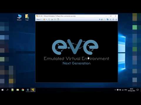

here good guide to start :
https://www.youtube.com/watch?v=SIZoaEbmXo8
