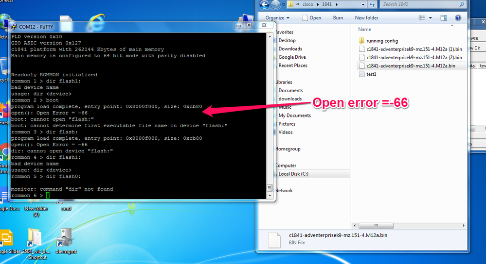

So this is the update, I was able to copy some of the iOS files that were on the flash to my tftp server. Then on my computer using the compact flash USB adapter, I deleted all the files from flash. I've then formatted the flash card in FAT. I then copied the K9 iOS onto the Flash, and I could see it was on the flash. When I rebooted the router with the Flash in the router, the router went directly into rommon mode and I got an open error 66 message. I think I'm just going to leave it for a couple of days until I get the new compact flash card. Then I'll know for sure if it's the router or the compact flash. I have one question. If the new compact flash is working, what's the correct way to format the flash card? Do I have to format the card in the router? Screen shot included.
Thanks again.
If the router is still in ROMMON, issue the command "format flash:".
Once the format is complete, eject the CF, copy the IOS from the computer to the CF.
Insert the CF back into the router and try booting again.
The format flash: command returned:
command "format" not found
When I get the new CF card I'll find out what's wrong.
Thank you.
If the router is in ROMMON, try the following:
flash_init
load_helper
format flash:
