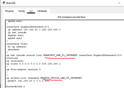

Would you guys help me make 8.8.8.8 reachable?
I did what was requested on my lap, but it did not work.
Pass for BranchR console: ConPa55sW
Pass for BranchR enable: BranchR
Pass for BranchSW console: ConPa55sW
Pass for BranchSW enable: BranchSW
requested :
To allow BranchTF PCs and Laptops to connect to Internet configure NAT in BranchR as follows:
  • Create an access-list defining allowed computers which can access internet
BranchR(config)#ip access-list standard BRANCH_OFFICE_LAN_To_INTERNET
BranchR(config-std-nacl)#permit 192.168.100.0 0.0.0.255
BranchR(config-std-nacl)#exit
  • Define inside and outside interfaces
BranchR(config)#int g0/0/0
BranchR(config-if)#ip nat outside
BranchR(config)#int g0/0/1
BranchR(config-if)#ip nat inside
  • Enable NAT/PAT
BranchR(config)#ip nat inside source list BRANCH_OFFICE_LAN_To_INTERNET interface g0/0/0 overload
2 Accepted Solutions
M02@rt37
Hello @ahmed31
On BranchR router please add static towards the ISP.
ip route 0.0.0.0 0.0.0.0 203.165.200.1
Best regards
M02@rt37
@ahmed31
Also take care the name of source list is not good!
After that PC should ping 8.8.8.8 !
Best regards

balaji.bandi
As per the configuration looks ok (since i do not use PT - so not able to open that file)
As long as the IP address matches (check is the correct source IP)  that should work as expected
