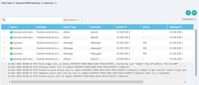

I have an SD-WAN test lab environment in EVE-NG where I'm hosting the vManage, vSmart, & vBond, along with various vEdge & cEdge routers.
I'm running into some strange issues where the vEdges do form tunnels to each other, I am able to ping site-to-site, but the vManage is complaining that the devices are out of sync. I don't have any templates configured yet or any type of policies, just a very basic config of full mesh for Service VPN 1.
Attached is the specific error message. Any ideas what this means?
The vManage, vBond, and vSmart all have "allow-service all" on their sdwan tunnel interfaces, so netconf should be permitted.
Thanks!
They did have that command. I ended up just restarting the topology and it magically worked
Thanks!

balaji.bandi
Make sure the vBond and vSmart configured correctly  - allow-service netconf
check my lab  reference :
https://www.balajibandi.com/?p=2028
BB

Hi All,
I am facing the same problem in a test lab. When I pushing the serial list to controllers it throws me the same error then after a while it goes to success with warning. serial file - error.PNG
When I am trying to onboard the vEdge with one of the serial it throws me an error that serial is missing in show control connections-history.
Output of show control connections shows nothing and show control connections-history shows the below error towards vBond.
