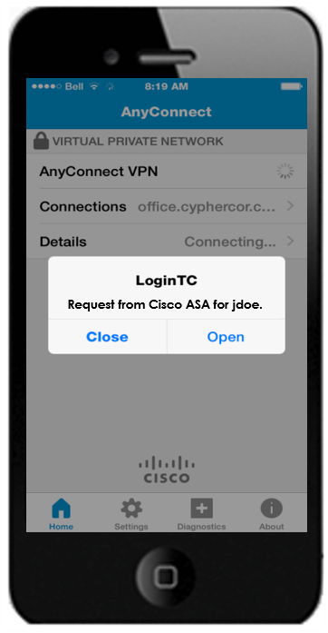

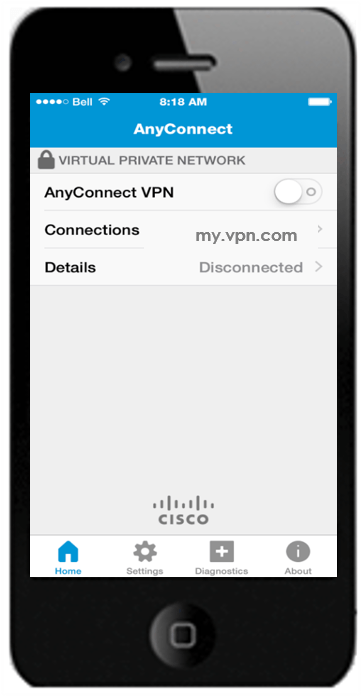

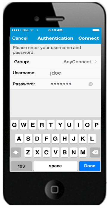

7. Access the VPN. To access the VPN, launch Cisco AnyConnect on your smartphone or tablet and “Add VPN Connection” by inputting your “Server Address.” To log in, enter your first-factor identification (username/password). At this point, unbeknownst to the app, it is in waiting: the LoginTC Connector, which was connected to your VPN earlier, has trapped the first-factor authentication and is orchestrating the two-factor authentication sequence, meaning it will only accept the request to access the VPN through the app once both factors have been satisfied. Once the LoginTC Connector gets a successful confirmation of the username/password, it initiates a wireless notification to your smartphone.
Add your VPN connection.
Enter your first-factor information.

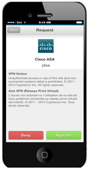

8. Approve the request that has been pushed to your smartphone or tablet. Opening the notification launches the LoginTC app where you can accept the access request.
LoginTC pushes a second-factor notification request to your device.
Approve the request with the tap of a finger.

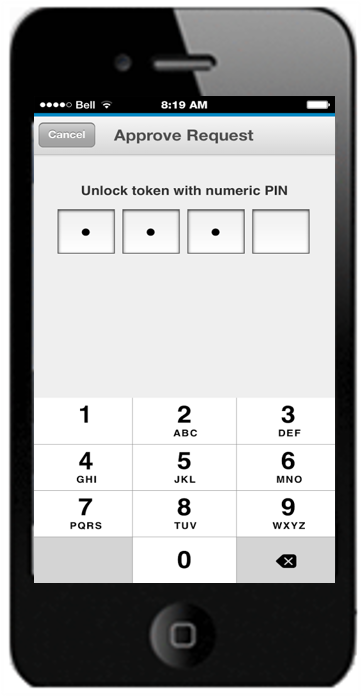

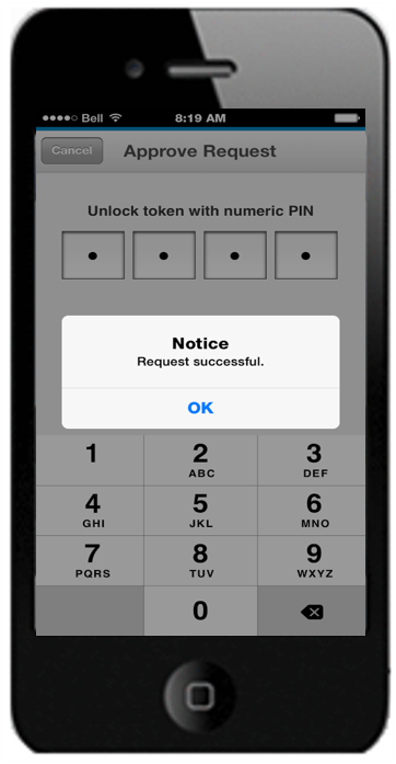

9. Unlock the token with your 4-digit PIN or passcode. Once the correct PIN or passcode is entered, the configured LoginTC RADIUS Connector will confirm the successful unlocking of the VPN token credential and grant you access to the VPN through the VPN client.
Set your PIN.
Unlock the token with your PIN.

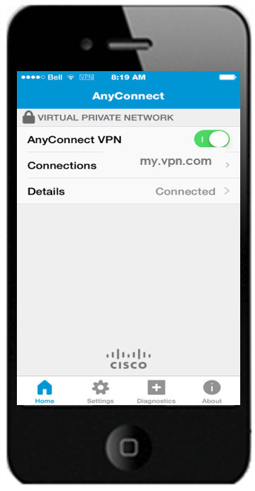

10. Connect to your VPN. At this point, if you re-open your VPN client, it will signify that you are connected to the VPN. A VPN symbol should also appear on your device’s status bar.
