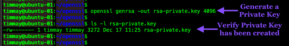

Generate a Private Key
Lets generate an RSA Private Key and then dig into it! We will use the cryptographers Swiss army knife, OpenSSL.
openssl genrsa -out rsa-private.key 4096

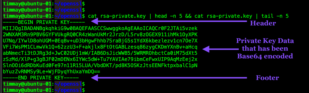

What does this private key file look like.  It's quite simple, it is a text file that contains a header, footer and some Base64 text.  There is a lot of text here and its nonsensical so I'm only going to show the first and last 5 lines.
cat rsa-private.key | head -n 5 && cat rsa-private.key | tail -n 5

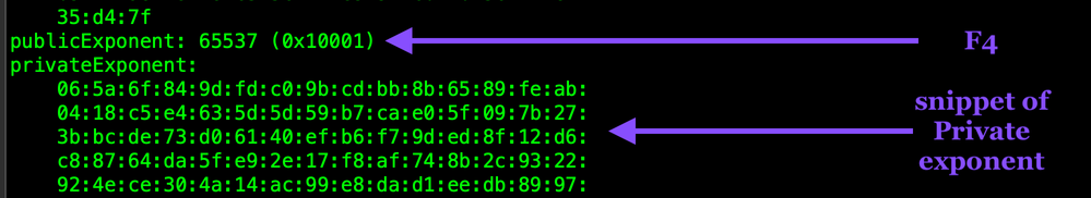

The Public and Private Exponent
There is a public (e) and private exponent (d).
The public exponent (e) is part of the public key and is typically a small, fixed value, in my testing its always been 65,537. This integer is also the fourth Fermat prime aka F4.
The private exponent (d) is part of the private key and is used in conjunction with the private key for decryption operations. The private exponent is an extremely large number, typically the same size as the modulus.

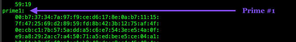

The Primes
There are two prime numbers (p) and (q). These are very large numbers. They are represented as hex digits. We will display them in decimal format later. These are likely not normal prime numbers either, only specific types of prime numbers are good candidates for cryptography. Prime numbers that are good for cryptographic purposes include Sophie Germain and Safe Primes and Strong Primes.

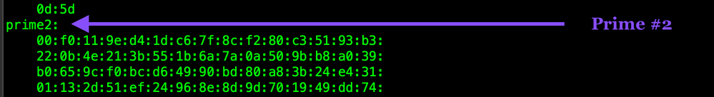

Prime #1 (p)
Prime #2 (q)

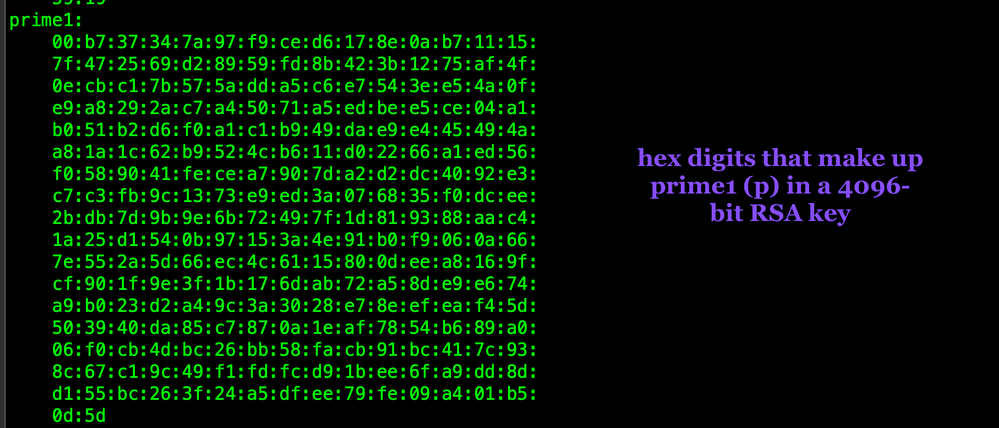

See here for Prime #1 and Exponent #1, they are just about the same size.
prime1:
00:b7:37:34:7a:97:f9:ce:d6:17:8e:0a:b7:11:15:7f:47:25:69:d2:89:59:fd:8b:42:3b:12:75:af:4f:0e:cb:c1:7b:57:5a:dd:a5:c6:e7:54:3e:e5:4a:0f:e9:a8:29:2a:c7:a4:50:71:a5:ed:be:e5:ce:04:a1:b0:51:b2:d6:f0:a1:c1:b9:49:da:e9:e4:45:49:4a:a8:1a:1c:62:b9:52:4c:b6:11:d0:22:66:a1:ed:56:f0:58:90:41:fe:ce:a7:90:7d:a2:d2:dc:40:92:e3:c7:c3:fb:9c:13:73:e9:ed:3a:07:68:35:f0:dc:ee:2b:db:7d:9b:9e:6b:72:49:7f:1d:81:93:88:aa:c4:1a:25:d1:54:0b:97:15:3a:4e:91:b0:f9:06:0a:66:7e:55:2a:5d:66:ec:4c:61:15:80:0d:ee:a8:16:9f:cf:90:1f:9e:3f:1b:17:6d:ab:72:a5:8d:e9:e6:74:a9:b0:23:d2:a4:9c:3a:30:28:e7:8e:ef:ea:f4:5d:50:39:40:da:85:c7:87:0a:1e:af:78:54:b6:89:a0:06:f0:cb:4d:bc:26:bb:58:fa:cb:91:bc:41:7c:93:8c:67:c1:9c:49:f1:fd:fc:d9:1b:ee:6f:a9:dd:8d:d1:55:bc:26:3f:24:a5:df:ee:79:fe:09:a4:01:b5:0d:5d

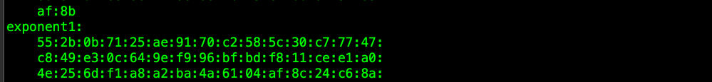

exponent1:
55:2b:0b:71:25:ae:91:70:c2:58:5c:30:c7:77:47:c8:49:e3:0c:64:9e:f9:96:bf:bd:f8:11:ce:e1:a0:4e:25:6d:f1:a8:a2:ba:4a:61:04:af:8c:24:c6:8a:e6:89:e4:82:13:a6:f5:7d:9d:ac:0c:e5:9d:0f:90:88:19:eb:82:c6:9e:e8:44:25:c8:6e:3d:ab:19:52:55:78:f6:87:91:73:69:7b:94:56:39:81:72:73:e4:9c:36:cb:06:e9:07:c9:ca:2d:63:79:d1:66:b7:0e:08:d3:b0:b4:f6:40:3a:ef:ab:bb:cc:bf:5f:e4:33:6c:ff:d1:d4:6d:bc:1d:e0:42:56:16:c0:04:29:ce:c1:df:b2:03:05:43:6f:ec:50:1b:85:57:42:84:6c:9b:a8:6a:ec:ca:51:a3:1b:bc:80:3d:7d:d3:ae:8c:6d:41:d5:6d:1e:69:e0:a8:3f:4e:28:4f:1f:bb:01:9a:88:bc:85:9a:be:0d:df:25:ed:33:27:f4:5a:60:4d:8d:11:47:f8:fd:94:3d:b9:71:e5:67:49:48:a3:91:51:e0:9b:e3:21:59:f6:93:a4:f6:6f:36:ba:dc:1c:eb:4a:7c:b1:4a:51:3c:97:98:5a:3e:0b:68:be:73:ed:57:96:28:b2:17:0b:a3:97:ec:e1:59:8d:d1:5d

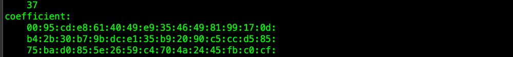

The Coefficient
The coefficient is another very large number that is used during Chinese Remainder Theorem optimization processes and helps with the decryption process.

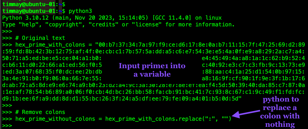

Lets take a look using some simple python code. First we will remove all the colons.
# prime1
hex_prime_with_colons = "00:b7:37:34:7a:97:f9:ce:d6:17:8e:0a:b7:11:15:7f:47:25:69:d2:89:59:fd:8b:42:3b:12:75:af:4f:0e:cb:c1:7b:57:5a:dd:a5:c6:e7:54:3e:e5:4a:0f:e9:a8:29:2a:c7:a4:50:71:a5:ed:be:e5:ce:04:a1:b0:51:b2:d6:f0:a1:c1:b9:49:da:e9:e4:45:49:4a:a8:1a:1c:62:b9:52:4c:b6:11:d0:22:66:a1:ed:56:f0:58:90:41:fe:ce:a7:90:7d:a2:d2:dc:40:92:e3:c7:c3:fb:9c:13:73:e9:ed:3a:07:68:35:f0:dc:ee:2b:db:7d:9b:9e:6b:72:49:7f:1d:81:93:88:aa:c4:1a:25:d1:54:0b:97:15:3a:4e:91:b0:f9:06:0a:66:7e:55:2a:5d:66:ec:4c:61:15:80:0d:ee:a8:16:9f:cf:90:1f:9e:3f:1b:17:6d:ab:72:a5:8d:e9:e6:74:a9:b0:23:d2:a4:9c:3a:30:28:e7:8e:ef:ea:f4:5d:50:39:40:da:85:c7:87:0a:1e:af:78:54:b6:89:a0:06:f0:cb:4d:bc:26:bb:58:fa:cb:91:bc:41:7c:93:8c:67:c1:9c:49:f1:fd:fc:d9:1b:ee:6f:a9:dd:8d:d1:55:bc:26:3f:24:a5:df:ee:79:fe:09:a4:01:b5:0d:5d"
# Remove colons
hex_prime_without_colons = hex_prime_with_colons.replace(":", "")
# Display the hex without colons
print(hex_prime_without_colons)

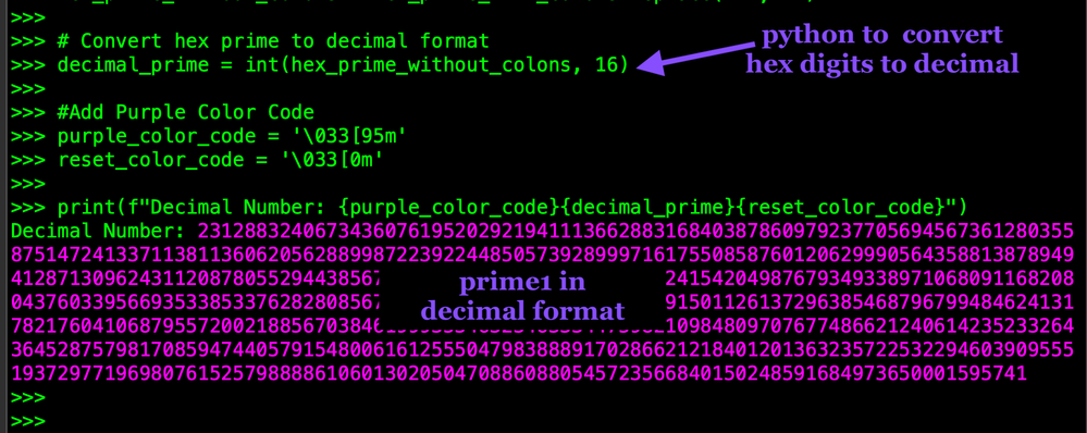

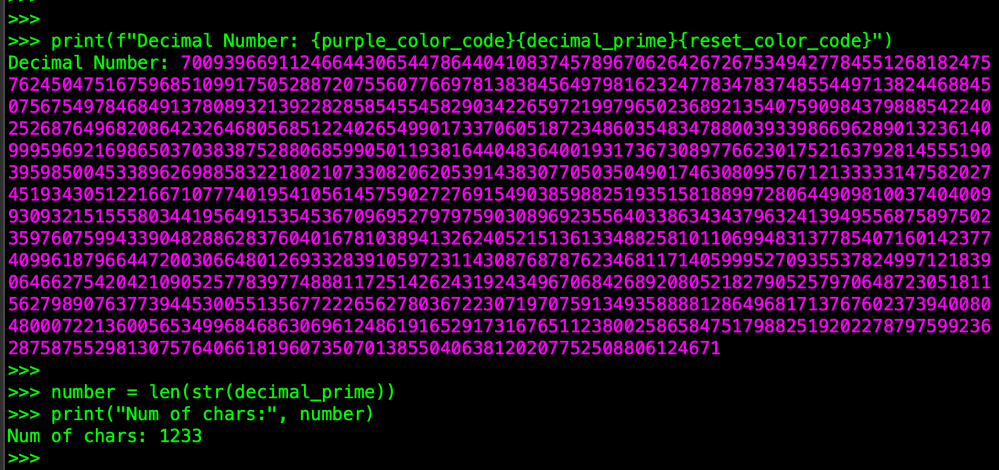

Now lets use some simple python code to convert this hex to a decimal number. Then print the decimal number in purple so it's easy to read.
# Convert hex prime to decimal format
decimal_prime = int(hex_prime_without_colons, 16)
#Add Purple Color Code
purple_color_code = '\033[95m'
reset_color_code = '\033[0m'
#Count the number of digits
number = len(str(decimal_prime))
print("Num of chars:", number)
print(f"Decimal Number: {purple_color_code}{decimal_prime}{reset_color_code}")
So that is prime1, it is 617 digits long. That is very large number.
Modulus
If the primes are both about 617 digits long, well how long could the modulus be. I ran the same code above on the modulus and the modulus in my private key is 1233 digits long! That is an extremely large number.
