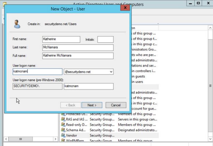

The first thing I usually do is create some test users and groups in Active Directory Users and Computers. Here are the following users and groups I created for the purposes of my lab:
  • Katherine McNamara - Domain Admin, BYOD-Users
  • Jessica Jones - Employee, BYOD-Users
  • Tony Stark - Vendor

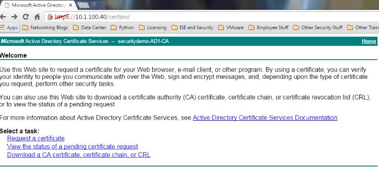

The next thing I like to do after this is to ensure that my Certificate Web Enrollment Page is working. Open the browser on a computer attached to the local network or on your Server 2012 VM and navigate to https://AD-Server-IP/certsrv and make sure you are getting the following page:

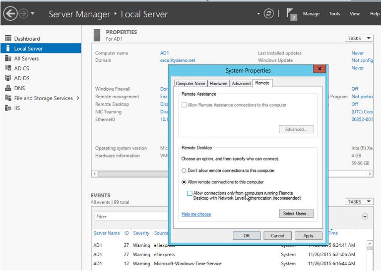

In Server Manager, click on Local Server on the left-hand side. In the Properties panel, click on Remote Desktop. This is where I like to allow Remote Desktop access so I don't have to console in from vSphere every time I want to get into my server.
