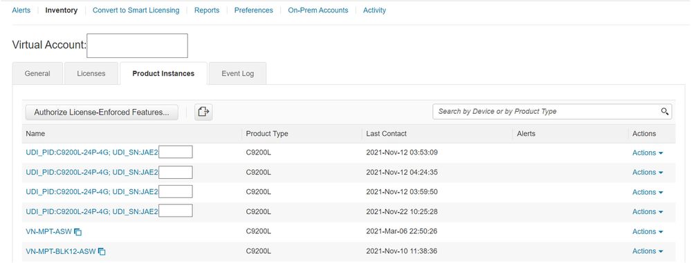

Dear All,
Hope you can give your help!
I have completed the configuration for activating the smart license, but when I check on the portal, in Product Instances tab just shows PID and SN.
Switch Ports Model SW Version SW Image Mode
* 1 28 C9200L-24P-4G 17.03.04 CAT9K_LITE_IOSXE INSTALL

Did you get an answer to this? It seems to affect my 9x00 stacks running 17+ code but the pre-17 stacks are still using their hostname. This PID/UDI is a real pain to cross-reference to an actual device.
Regards, JB.
> I did not get an answer to this yet
17.3.x added the following lines to your config:
license smart privacy hostname
license smart privacy version
Issue "no license smart privacy hostname" and your devices will send hostname to the CSSM

In IOS 17.3.x there are two default commands which are added as part of an upgrade:
This enables privacy and so the device does not send the hostname to the CSSM. If you issue "no license smart privacy hostname" it will send the info to the CSSM.
