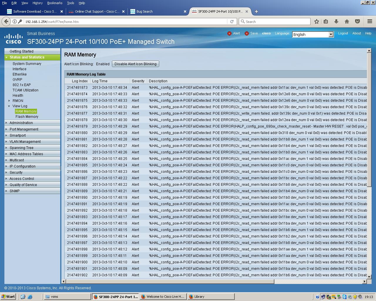

Boot software versions 1.0.0.4 and 1.1.0.6 files urgently needed to downgrade my firmware from 1.3.5.58 to 1.2.7.76.
I was told that version 1.2.7.76 is a workaround the POE FAIL error I have on my switches.
I cannot downgrade straight from 1.3.5.58 to 1.2.7.76 unless the boot code is downgraded first.
All helps to get these files will be appreciated. See attached files.

I doubt that the downgrade will resolve the problem with this error, but you can try.
What happens if you try to downgrade to 1.2.7.76?

Mipopov,
To your 2nd question, the system complains of illegal format.
Iguess the bootcode has to be downgraded lower than the present 1.3.5.06.
That's why I need the boot files.
