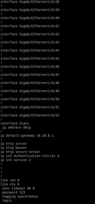

Hello could you help me with this error help me with this error it does not let me enter the web console because I was trying to put a backup where it was not and now I can not get it to run the web error is 404 not found I have the switch catalyst 2960-X and here I leave a picture of my CLI witch the command "dir" executed.

That input not going to help what is configured on the device (do type below commands on the device and post here).
show version
show run
BB
how did you pull this config, using SSH ? or from console ?
what is  device IP from you are accessing ?  Are you able to ping the IP address of switch  10.10.0.2 ?
BB
How did you get this configuration using SSH? or from the console?
From the console because the ssh does not work for me either
What IP of the device are you accessing?
10.10.0.2
Can you ping the switch IP address 10.10.0.2?
Yes
