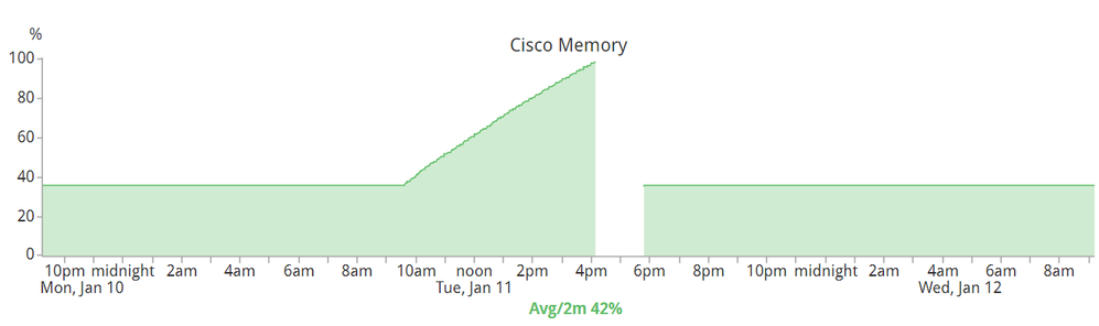

Another example is below:
3850 stack, 16.12.63850 stack, 16.12.6
The spike was when the stacking cable (Catalyst 3850) because un-secure.  Notice how fast the memory utilization ramped up before the switch crashed?
