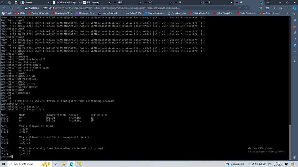

05-04-2024 12:35 AM
I run lab for you and Add ID column to wiresharke this column for VLAN ID use in traffic
as you can see R4 receive tag vlan 20 from R3 since native is 33 and forward it as untag to R5 since the native vlan 20
Again try avoiding this in real network
MHM
