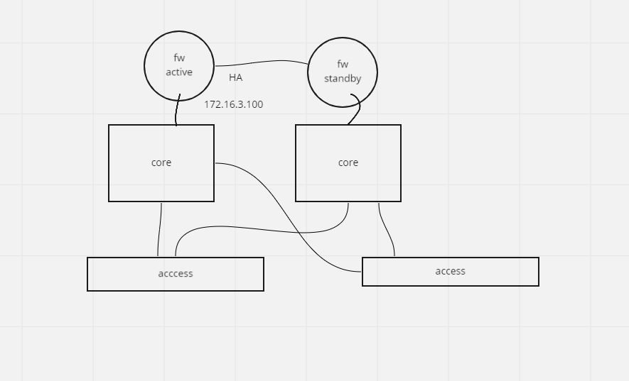

hi @Jon Marshall @Flavio Miranda
The below solution will work ? . I mean an active standby firewall deployed , If any failover happened  how the traffic will flow
Thanks
Looking at the diagram you posted, access-layer redundancy is fine, and so is the redundancy between the firewalls and cores. The issue is core layer redundancy. Since there are no links between the core switches if, for example, the link between the core switch on the left and the active firewall fails, the traffic has nowhere to go. So, if you add a link between the core switches and configure all the devices correctly, the failover/redundancy should work just fine.
