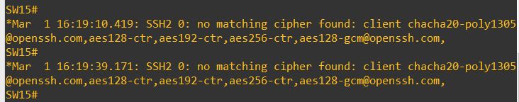

Hi I have an issue when accessing a switch-192.168.1.15 via ssh with ansible. The ssh is configured correctly in the switch because the switch can be accessed by its neighbor switch via ssh. Please see below screenshot. Anyone can share any solutions? Thank you!

interfacedy
Please see below. The error changed. The second peicture is from the switch
Check and see Linux has cipher :
$ ssh -Q cipher
try :
ssh -vvv -c aes256-cbc admin@192.168.1.15
check you can add to Linux ciphers
