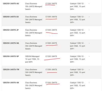

If you look at Cisco doc for CBS350 EoL, the replacement model is the 1300.
 When Cisco recommend a model for replacement, I believe they take in consideration that one model will fulfill all the functions and capacity of the previous one.
  As an example, the model CBS350-48NGP-4X-AR has not replacement indicated by Cisco, which means, 1300 would not be able to replace this device.
https://www.cisco.com/c/en/us/products/collateral/switches/business-350-series-managed-switches/business-cbs350-series-managed-switch-mod-eol.html
