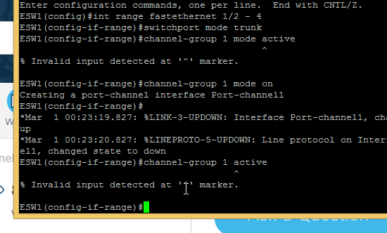

I am trying to create Ethernet channel between 2 switches 3725

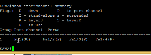

now in trying to create LACP the keyword active/passive not working, however it looks like I can define static ethernet channel

other switch has similar issue after I defined encapsulation and trunking
it seems I can statically configure the ether channel, however I cannot configure LACP using active or passive keywords

It is strange that you don't have the options to configure LACP modes but static (mode on) usually works fine too.

You are using the keyword "mode" when you force it on, but not when you are trying to do LACP. See below.
interface Ethernet1/11
  description FreeNAS2 - P1
  switchport access vlan 252
  spanning-tree link-type point-to-point
  channel-group 12 mode active
 You also need this in global config.
feature lacp

I'm thinking this may be due to using a router base as a switch, as I am not using any native switch images for router.
Martin L
Looks like you using Router image with Ethernet switchport extension/module, which may not support LACP.  Not all L2 futures are supported by such image.
Otherwise, IOL /IOU virtual images may not allow you to use LACP as they are not supported.  It supports only manual ether-channel.
