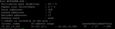

Hi @Kasun Bandara
Here result of my pool, in this pic are my pool is full?
Your dhcp pool is full. You are currently leasing 246 address and excluding 8. This makes 254 addresses in total which is equal to the size of your pool.
If we decrease the lease time, will the ip used will decrease at the time or should wait? Also in the previous picture there are 8 address excluded, how we can know which ip address is excluded?
Here my pool config
If you decrease the lease time, I assume that the new lease time would only apply to clients requesting or renewing their IP address. This means that the used IPs would not necessarily decrease right away.
If you do "sh run", in the configuration you will see excluded addresses right next to dhcp pool config. Or you can do "sh ip dhcp binding" and find the addresses that are not being leased.
I do clear ip dhcp binding, and found the excluded address is increased.
When the leased address is 37,the excluded address is 12
When the leased address is 70,the excluded address is 17
On the router i only have 5 IP excluded
So my question is, when there are any client with static IP this will counted as excluded address?

Wifi' so client associations get IP and then leave and the IP will there until leased time end.
The solution I think in wlc' do you config idle timeout?

can we make an alert if there any dhcp pool which reach 90% utilization by SNMP maybe?
In your dhcp pool configuration, you can configure "utilization mark high percentage log". This will create a system log whenever the utilization percentage specified is exceeded.
Hmm'
Utilization mark high can use to generate log (for SNMP i will check OID of dhcp pool)' this log can used then with EEM to automatically clear ip dhcp binding.
But to be honest' I dont like this solution I will check how can prevent guest exhaust the pool.
MHM
Do the utilization mark  (high/low) : 100/0 mean we can change the utilization mark to some values?
Yes you can
