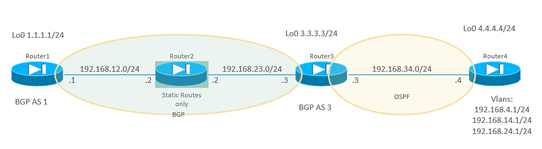

I’m wanting to simulate a network my company manages, so I want to lab a similar network to understand it. I’m trying to get ebgp to work between two routers (R1 & R3) separated by a router (R2) that only does static routing. There is more to the production network and this is very simplified.
Configuring routing between 4 routers:
Router1 is configured with bgp AS 1 to Router 3
Router2 is configured with static routes only
Router3 is configured with bgp AS3 to Router 1 and ospf with Router4.
I want to form  ebgp neighbors between R1(bgp AS1) and R3 (BGP AS3 and OSPF), R2 has only static routes, R4 is OSPF.
I want to have access to the vlans from router 1 that are on router 4.
I’m not getting this to work. I can ping from R1 to R3 loopback interfaces, but the neighbor relationship remains idol.
Router 1 config:
  • Router bgp 1
  • Neighbor 192.168.23.3 remote-as 3
Router 2 config:
  • All static routes ! I can ping from R3 to 1.1.1.1 and can also ping from R1 to 3.3.3.3
  • Ip route 1.1.1.0 255.255.255.0 192.168.12.1
  • Ip route 3.3.3.0 255.255.255.0 192.168.23.3
  • Ip route 192.168.4.0 255.255.255.0 192.168.23.3
  • Ip route 192.168.14.0 255.255.255.0 192.168.23.3
  • Ip route 192.168.24.0 255.255.255.0 192.168.23.3
Router 3 config:
  • Router bgp 3
  • Neighbor 192.168.12.1 remote-as 1
  • Router ospf 1
  • Network 192.168.34.0 255.255.255.0 area 0
Router 4 config:
  • Router osfp 1
  • Network 0.0.0.0 255.255.255.255 area 0

In the lab there isn't any more to the config other then what I posted.
