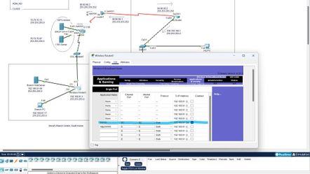

Hi Cisco community members,
I'm a student currently studying and learning about networks fundamentals so basically a beginner and would like some help or advise on my mini activity.
Allow me to put up a screenshot of the activity.
The activity needs to be able to access both HQ & Branch website from either network and I'm able to access both from the network on the left side. But on the right side I can't access the branch website.
I tried pinging from the right side network to the left side. The most i can reach from the right network is up till the ISP side which is 70.70.70.0
It would be appreciated if someone could advise me on it.
@Ch Teo
 I have found the solution. The Linksys router must have a port redirect from external IP address 70.70.70.155 to the internal server 192.168.91.94.
As the ISP is able to get to the 70.70.70.155, all you need to do is change the DNS server to resolve the URL
www.branch.com to the IP address 70.70.70.155.

@Flavio Miranda First of all thank you for your response.
I have attached and zip the file as suggested, do take a look at it.

But I'm sorry for not stating that the activity requires me to not modified the Internet cluster portion or add another device. Therefore, I have to stick to this setup for this activity. nonetheless, I appreciate your detailed explanation it really helps me understand.
But from what my lecturer taught us was that we have to add in the IP address of the webserver on the wireless router GUI and we would be able to go into the website from outside network, but I tried from the HQ PC and was prompt with a request timeout.
Overall my activity requires me to be able to access both websites from both networks.
Wireless Router GUIWireless Router GUIHQ laptop unable to access www.branch.comHQ laptop unable to access www.branch.com

@Ch Teo
Hi @Flavio Miranda,
Appreciate you taking the time and effort to assist me on my activity.
I can't believe i miss out on that small little detail but in the end, I did learn something from the experience. There I was thinking that the DNS side must include the actual IP of the web server.
But your explanation was clear enough to let me understand it. Once again thank you for your assistance.
You are welcome. It took me sometime to understand also.
