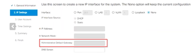

"default route as follow 0.0.0.0.0  0.0.0.0.0 192.168.10.1" --> this is then the equivalent for

On the CBS350, you need to create this, change accordingly, this is an example.
and here is where you can add a default (static) route pointing to your nonCisco router.

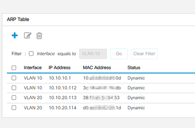

in ARP Table we can see the Clients (IPs are manually added on the clients)
ip default-gateway 10.10.10.1 --> works only for VLAN 10
regardless - if the checkbox is set or not. Client from VLAN 10 can ping also VLAN 20 IP, no behavior change noticed, if this checkbox is on or off.

my ISP Router ARP
The key thing about accessing the Internet from private IP addresses (192.168.n.n) is Network Address Translation. Clearly your ISP is translating addresses in network 192.168.10.n. And pretty clearly your ISP is not translating addresses in other 192.168 networks. Your CBS350 does not support NAT. So you need to ask your ISP if they would be willing to do translation for other networks.
