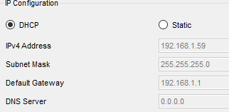

I also have a question why the dhcp server does not assign a dns server?
you need to exlcude the IP addressof the DNS server from the range that is assigned to clients. The best would be to set the start address to .6 (see screenshot).
