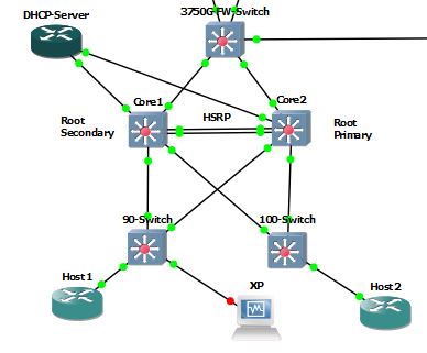

I'm trying to build a typology similar to my work in GNS3, I'm using routers with the NM-16ESW module for 16 switch ports.  Anyway I'm trying to get the host on the VLAN 90 switch an IP address via DHCP but it's having none of it. Core 1 and 2 are using HSRP for all our VLANs, I though the best way to add a DHCP server using a router would be to add it to both cores and using /30 subnets and advertise into OSPF and add the ip-helper address to the VLANs on each core.  Someone did suggest  making the 2 ports for the DHCP server a port channel, but I wasn't sure how I woudl configure this on the to cores.

On the host 1 if I run a "shut" , "no shut" on fa 0/0 and run DHCP debug commands on the DHCP server I get this:
*Mar  1 00:36:19.915: DHCPD: Sending notification of DISCOVER:
*Mar  1 00:36:19.915:   DHCPD: htype 1 chaddr cc0a.3714.0000
*Mar  1 00:36:19.919:   DHCPD: remote id 020a0000c0a8290100000000
*Mar  1 00:36:19.919:   DHCPD: circuit id 00000000
*Mar  1 00:36:19.919: DHCPD: DHCPDISCOVER received from client 0063.6973.636f.2d63.6330.612e.3337.3134.2e30.3030.302d.4661.302f.30 on interface FastEthernet0/0.
*Mar  1 00:36:19.919: DHCPD: Seeing if there is an internally specified pool class:
*Mar  1 00:36:19.919:   DHCPD: htype 1 chaddr cc0a.3714.0000
*Mar  1 00:36:19.919: DHCPD: there is no address pool for 192.168.41.1.
*Mar  1 00:36:19.935: DHCPD: Sending notification of DISCOVER:
*Mar  1 00:36:19.935:   DHCPD: htype 1 chaddr cc0a.3714.0000
*Mar  1 00:36:19.935:   DHCPD: remote id 020a0000c0a8290501000000
*Mar  1 00:36:19.935:   DHCPD: circuit id 00000000
*Mar  1 00:36:19.935: DHCPD: DHCPDISCOVER received from client 0063.6973.636f.2d63.6330.612e.3337.3134.2e30.3030.302d.4661.302f.30 on interface FastEthernet0/1.
*Mar  1 00:36:19.935: DHCPD: Seeing if there is an internally specified pool class:
*Mar  1 00:36:19.935: DHCPD: there is no address pool for 192.168.41.5.

Can you show the configuration of the DHCP server router?
Here it is:

Nothing is jumping out at me to be honest! What happens if you try and create a reservation using client-identifier?
Not tried that before, how do I do that?

That is correct. Just something I did notice, you don't have any ip dhcp excluded addresses configured on the DHCP router. Is this just missing from your output or are they not configured? You would need to exclude any addresses from the pool that have already been assigned.

Yes excluded IPs are included as part of the DHCP pool, sorry I should of mentioned.
It's as if the DHCP discovers are not reaching the DHCP server.

Would it be possible for you to disable HSRP and drop all the connections from Core 1 except to the DHCP server and from the DHCP server to your root primary?
Is it normal to add a DHCP server this way using a router, should I be using a trunk from the router to the 2 cores instead?

Same issue I'm afraid.  I just added a router on Core 2 on vlan 90 and made it a DHCP server and added a scope for the 192.168.90.x subnet and it was ok.  It just seems the IP helper address isn't forwarding the offers.
I wondered if the host 1 could reach the DHCP router so I added a static IP and it can ping 192.168.41.1 and 192.168.41.5.

I just lab'd this in GNS3 and managed to get it working. I wasn't able to replicate your topology fully as my laptop is not powerful enough! I used two routers (DHCP server and host) and a single "multilayer" switch, and I didn't use OSPF.
On the DHCP server, disable IP routing, or as in your topology, make sure there is a route back to the .90 vlan on your DHCP server router.
On the link between the host router and the layer 2 switch, I changed to a trunk on the layer 2 switch, and a sub-interface with the encapsulation set to vlan 90:

This is for the host?

What happened when you tried the lab as layer 3 and not layer 2?
Yep, the sub-interface should be configured on the host router.
The switch was set up as a layer 2 trunk (for the host router) and layer 3 interface (for the DHCP router) as well as the SVI for vlan 90.
It made me think (from an ROAS perspective) that the interface on the host router would be considered to be in the native vlan (1). This would not match the vlan 90 configuration.
