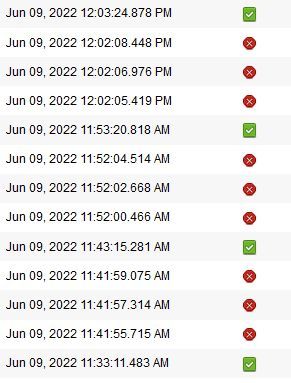

we have an ISE 2.7.0.356 and Cisco switch WS-C3560X-48P.
A few clients are authenticating every 10 minutes, first they fail, then succeed.
They alway loose the connection for some time.
This is how the switch-log looks like (this client is authenticated by its MAC-address configured in the ISE. But other client with same issue is authenticated by certificate).
Any suggestions?
Thanks.
Jun 9 03:49:07.574: %DOT1X-5-FAIL: Authentication failed for client (4b6c.91e0.5937) on Interface Gi0/19 AuditSessionID 0A64010200000BD52C9ADB8B
Jun 9 03:49:09.075: %DOT1X-5-FAIL: Authentication failed for client (4b6c.91e0.5937) on Interface Gi0/19 AuditSessionID 0A64010200000BD62CA412D7
Jun 9 03:49:10.678: %DOT1X-5-FAIL: Authentication failed for client (4b6c.91e0.5937) on Interface Gi0/19 AuditSessionID 0A64010200000BD62CA412D7
Jun 9 03:50:26.411: %DOT1X-5-FAIL: Authentication failed for client (4b6c.91e0.5937) on Interface Gi0/19 AuditSessionID 0A64010200000BD62CA412D7
Jun 9 03:59:11.451: %DOT1X-5-FAIL: Authentication failed for client (4b6c.91e0.5937) on Interface Gi0/19 AuditSessionID 0A64010200000BD62CA412D7
Jun 9 03:59:12.869: %DOT1X-5-FAIL: Authentication failed for client (4b6c.91e0.5937) on Interface Gi0/19 AuditSessionID 0A64010200000BD82CAD492F
Jun 9 03:59:14.261: %DOT1X-5-FAIL: Authentication failed for client (4b6c.91e0.5937) on Interface Gi0/19 AuditSessionID 0A64010200000BD82CAD492F
Jun 9 04:00:30.380: %DOT1X-5-FAIL: Authentication failed for client (4b6c.91e0.5937) on Interface Gi0/19 AuditSessionID 0A64010200000BD82CAD492F
Jun 9 04:09:14.910: %DOT1X-5-FAIL: Authentication failed for client (4b6c.91e0.5937) on Interface Gi0/19 AuditSessionID 0A64010200000BD82CAD492F
Jun 9 04:09:16.328: %DOT1X-5-FAIL: Authentication failed for client (4b6c.91e0.5937) on Interface Gi0/19 AuditSessionID 0A64010200000BDC2CB67DDC
Jun 9 04:09:17.830: %DOT1X-5-FAIL: Authentication failed for client (4b6c.91e0.5937) on Interface Gi0/19 AuditSessionID 0A64010200000BDC2CB67DDC
Jun 9 04:10:33.748: %DOT1X-5-FAIL: Authentication failed for client (4b6c.91e0.5937) on Interface Gi0/19 AuditSessionID 0A64010200000BDC2CB67DDC
Jun 9 04:19:18.124: %DOT1X-5-FAIL: Authentication failed for client (4b6c.91e0.5937) on Interface Gi0/19 AuditSessionID 0A64010200000BDC2CB67DDC
Jun 9 04:19:19.744: %DOT1X-5-FAIL: Authentication failed for client (4b6c.91e0.5937) on Interface Gi0/19 AuditSessionID 0A64010200000BDD2CBFB30F
Jun 9 04:19:21.254: %DOT1X-5-FAIL: Authentication failed for client (4b6c.91e0.5937) on Interface Gi0/19 AuditSessionID 0A64010200000BDD2CBFB30F
Jun 9 04:20:37.776: %DOT1X-5-FAIL: Authentication failed for client (4b6c.91e0.5937) on Interface Gi0/19 AuditSessionID 0A64010200000BDD2CBFB30F
