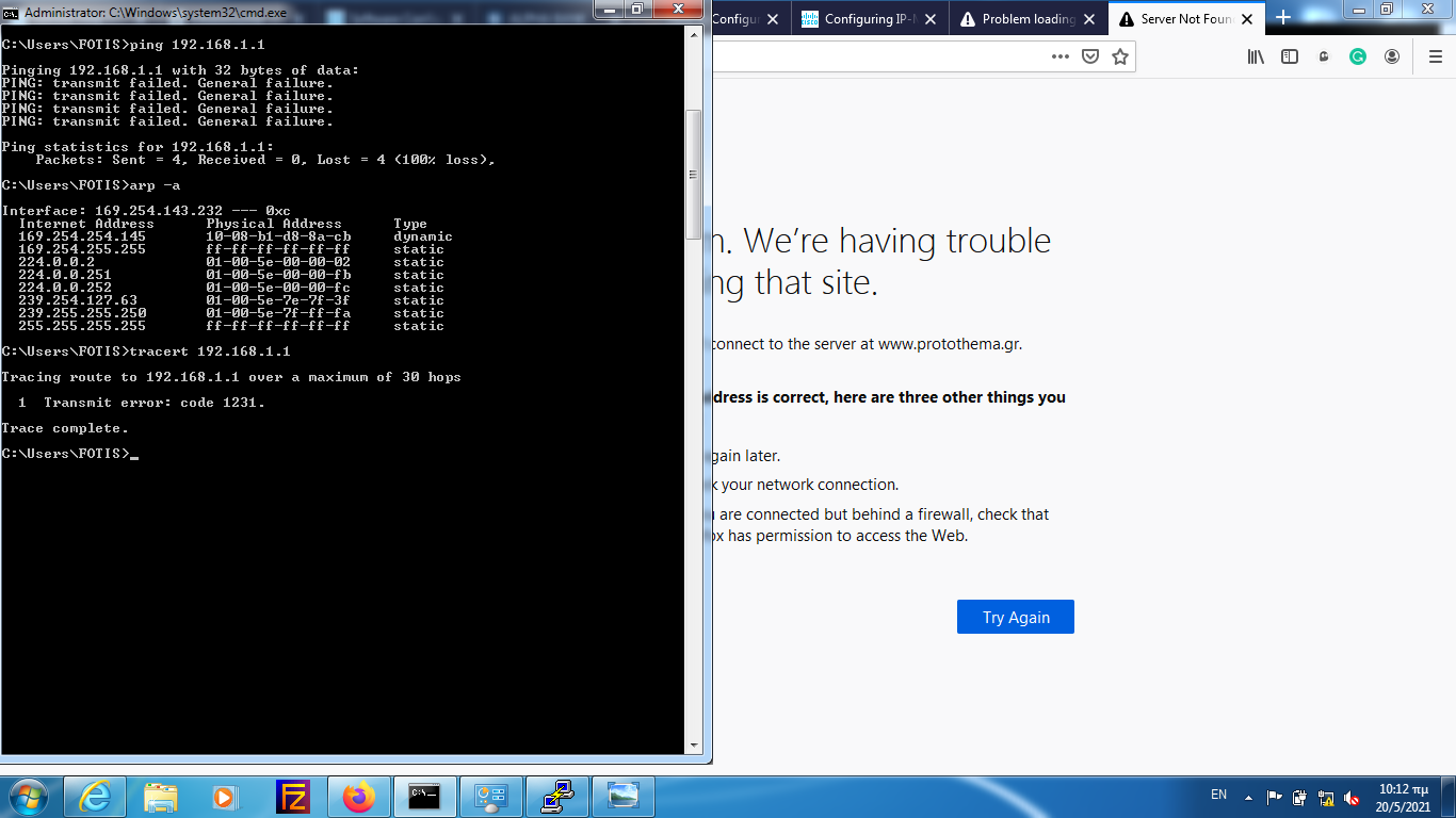

I was ready to post! This is the ping,arp -a  screenshot. Now it's working though, so I don't know if ipconfig will help you
Thank you for the new information. The arp output is quite helpful. And at this point ipconfig would not be helpful. I see 2 important things in the arp output:
1) there is no arp entry for 192.168.1.1. This is why the ping is failing with transmit failure.
2) the arp entries show that the PC is currently using IP address of 169.254.254.145
This confirms that the suggestion about the problem being related to DHCP is correct. It appears that the PC has lost its valid IP and is using the 169.254 address because it is not able to renew its DHCP lease. So the question becomes why is the PC able to get an IP address initially but not able to renew the address? Perhaps seeing the running config might help us understand this?
HTH
Rick

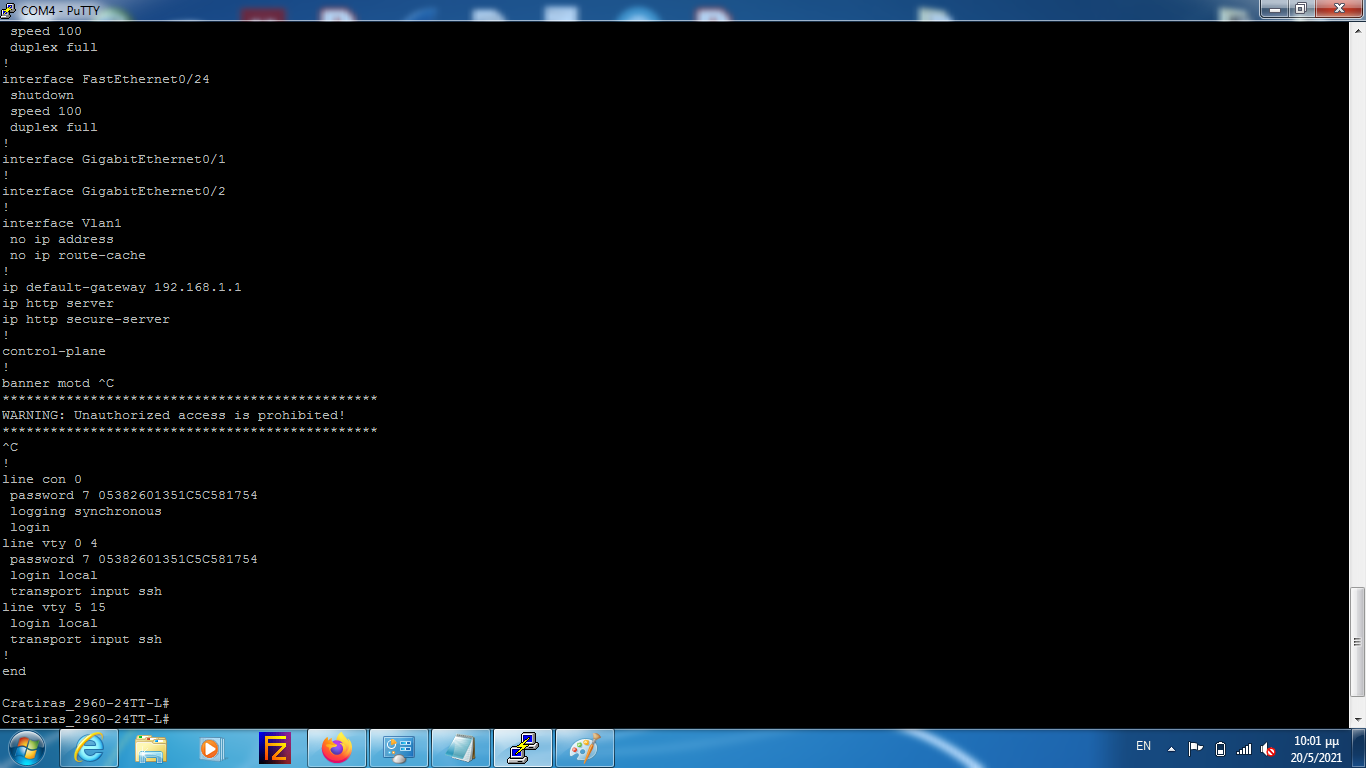

Thanks Rick! I also post the run conf but it's the current one with the changes I made this morning and for now is still working.
