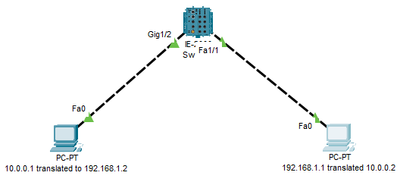

Thanks for your suggestion, it now worked as per below topology and below configuration
l2nat instance TEST
instance-id 1
fixup arp
fixup icmp
inside from host 192.168.1.1 to 10.0.0.2
outside from host 10.0.0.1 to 192.168.1.2
int G1/2
l2nat TEST
I am testing PC TO PC and PCÀ is connected to Fa1/1 Port. Presentl
I believe there is limitation fas1/1 port to use for the solution you looking to deploy, check the document it only works Gi1/1 and 1/2 i guess.

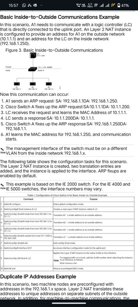

Addition to this I check on cisco website and as per screenshot it should work. But same thing is configured but didn't worked. I am not sure whether the LC and PC in this screenshot is directly connected to a single switch or there is another intermediate switch on which LC is connected.
