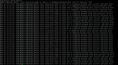

Hi, i have a issue between two sites of  the company.
we have a main site (headquarters) and recently we connect a new site by a Lan to lan link. We trunk all vlans from main site to new site with a trunk port. And we having a problem with the clients of the new site, the mac address client flap between LAN ports (port-channels) and the wan port (gi 1/0/1).
attach diagrams.
logs:
I can't find any inconsistent configuration or loop that might be causing this behavior.
Thanks for you help
