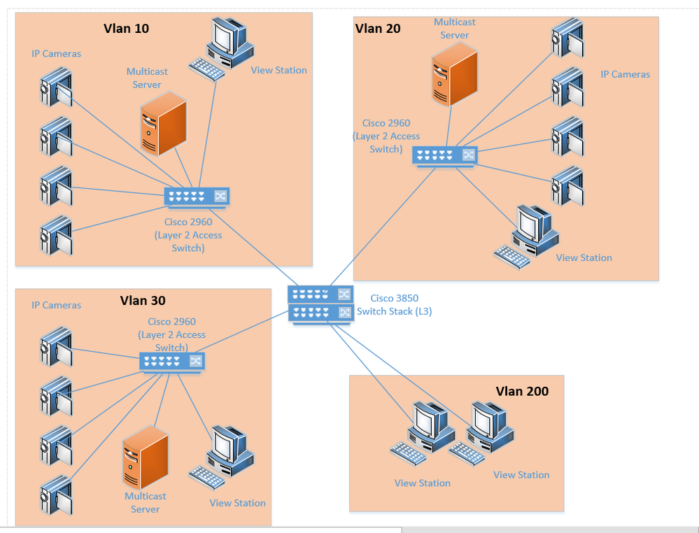

OK, in that case, can you please draw a quick diagram of your network, including the servers and receivers locations.

Sure.. Give me a bit and I will have one.
In this drawing all links from 2960 switches to 3850 switchstack are 1G fiber links.. Each View Station view local multicast except for the vlan 200 stations.. They view all multicast. Every vlan GW is located on the 3850 stack. The 2960 links to the 3850 stack are configured as access ports..
Anymore info needed let me know.
OK, so as I suspected, all your multicast L3 is happening on a single device. There is no reason why it wouldn't be able to forward multicast traffic. At least not in the control plane. I would search for bugs. Also, I would try to ping the multicast groups from the 3850 stack and see what happens when multicast streams break.
