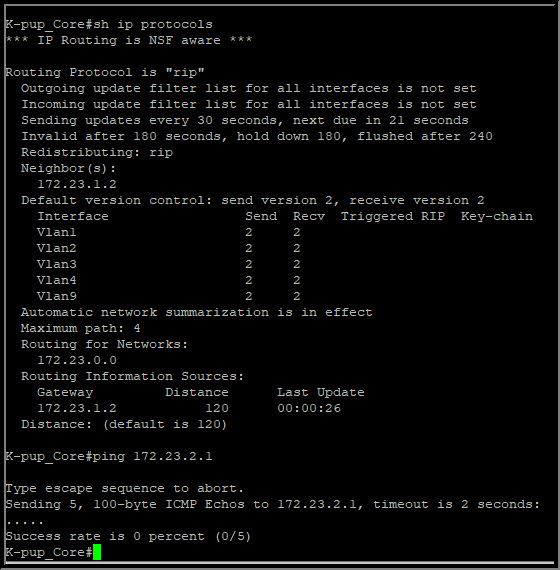

Hey There. Looking for some guidance.
Trying to refresh and re-learn vlan's on cisco gear. there is something i am missing as only vlan 1 will get internet, the rest, nothing. intervlan routing is working as i have enabled the ip route and DHCP is working to each vlan from my DHCP windows server. 2 main things that are getting me frustrated and that is internet to the other vlans and reaching my second switch.
I've added the route 0.0.0.0 .0.0.0.0 to 172.23.1.2 to get internet working on vlan 1
The other vlans, can reach other vlans and i can ping everything properly.
Just No internet. I read a few forums that say add static routes in my sonic wall, which i am trying to learn and figure out. i followed a tutorial to add a static route for vlan 2 but that still didn't work. from my core switch 1, i can ping all vlans interfaces etc etc.
i also CANNOT ping or reach switch 2,  172.23.1.3, when i enable trunking on the first switch 172.23.1.1.  even though my tag's and untags are working to get camera data from the switch 2, i cannot reach or ping this switch until i turn port 1/0/48 on switch 1 into access mode.
Here is my setup:
AD/DNS/DHCP - 172.23.1.150
attached is my running config form both switches.
what am i missing??

Thanks for the details. This is helping me learn alot! I appreciate it.
So instead of static routes, based on the reading, static routes isn't the best anyway on larger networks, i decided to use the RIP routing protocol.
So i enabled this on my sonic wall and trying to still learn what the metrics means:
I then went into my 3750 and enabled the same version: Cisco.jpg
Does this look right to you?
Also, the stupidest thing is happening now to me. I am unable to ping any vlan interface ip address anymore from my core switch??? if you see the image above, i cannot ping vlan 2 anymore:
Nothing has changed as far as I am aware. i confirmed that ip routing is enabled in the running config as well. but just in case i missed something, here is my running config as again

Thanks for the all the help. really love learning this stuff.
also, even if RIP routing is enabled and working, do I still need to enable NAT on the sonic wall for every vlan? i assume not since it has learnt all the vlans from rip routing on sonic wall interface X0 (LAN)?
