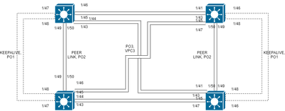

I created diagram with connections. Hope you can see how it is configured.

But i allready posted the diagram. Here it is, once more:
I see many case
the Engineer misconfig the
domain in upper NSK peer and lower NSK peer must different
the vPC use for connect all "four" NSK but be same.
please refer to photo above
Thank you for your answer.
The diagram that you provided looks like my configuration. I used different domains for pairs and same VPC and PO name for cross-link.

second
AGG<-->DC_L2_link << this discerption in all PO vPC between two Pair,
can you check the cabling ?
there are four port in each NSK
each two must connect to different NSK peer in other Pair.
just check thus point.
Here are my connections.
Just out of pure despair I changed config on DC pair to use MGMT as keepalive. Result is the same.
I triple checked all my cabling and it is all good.
