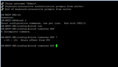

What would I put for offset?
Also, would I need to change this when the clocks go forward? I want this to be fully automatic you see as I have 30 switches.

tmourelle
What would I put for offset after defining BST or GMT?
            >....I want this to be fully automatic you see as I have 30 switches.
                - Use : clock timezone BST 0
                             clock summer-time BST recurring last Sun Mar 0:00 last Sun Oct 0:00
 M.
