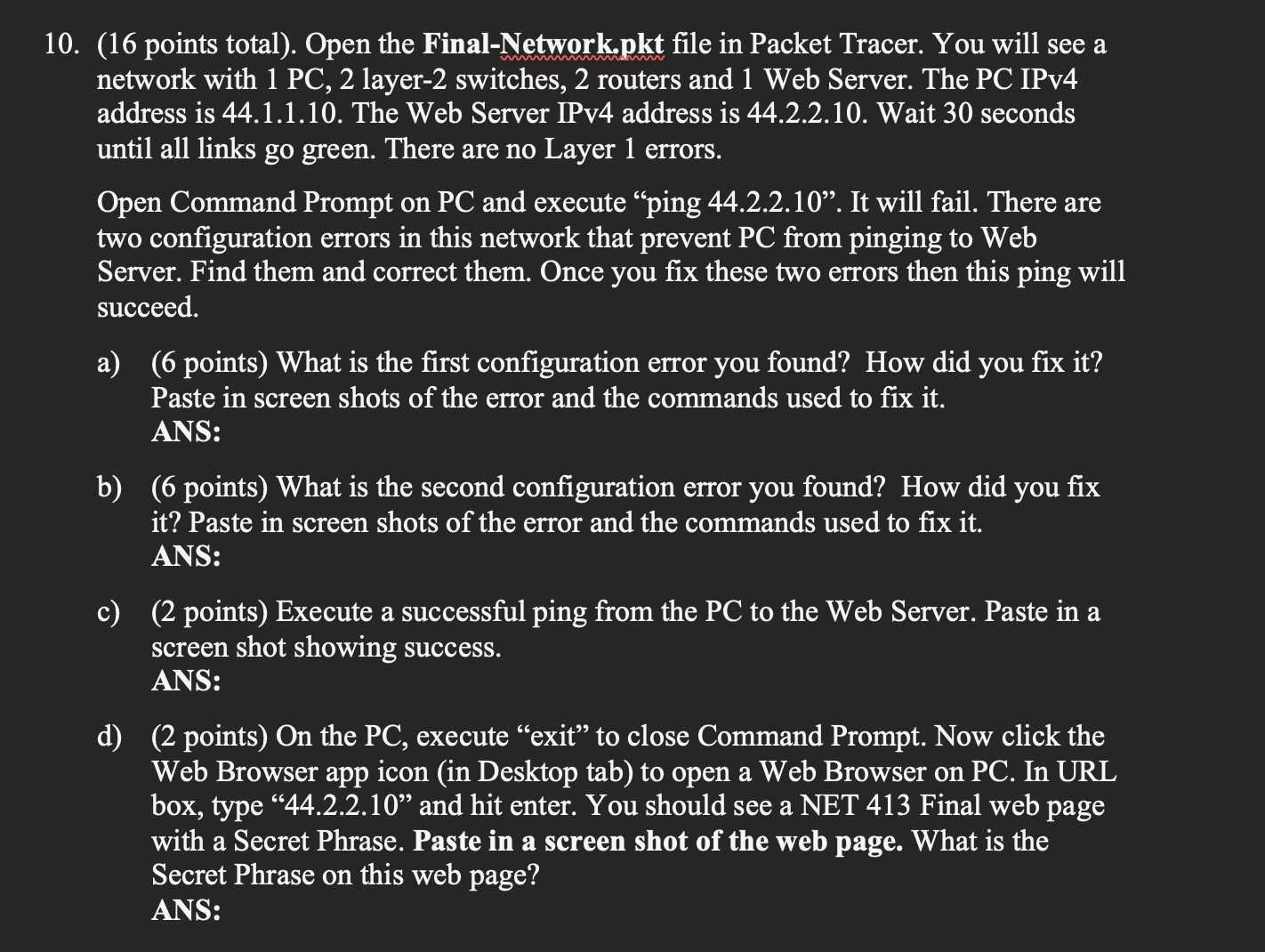

I apologize in advance if this is the wrong community. I'm working on a lab for a course and need some assistance with troubleshooting in Packet Tracer. There are supposedly two things wrong with the Packet Tracer configuration and I cannot seem to figure it out. I've attached an image of the instructions and the topology. Below is the information associated with each device:
PC IPv4 Address: 44.1.1.10, Subnet Mask 255.255.255.0, Default Gateway 44.1.1.1
Interface Fa0/0 Router 1 IPv4 Address: 44.1.1.1, Subnet Mask 255.255.255.0 (44.1.1.2)
Interface Fa0/1 Router 1 IPv4 Address: 69.0.0.14, Subnet Mask 255.255.255.248
Interface Fa0/0 Router 2 IPv4 Address: 44.2.2.1, Subnet Mask 255.255.255.0 (44.2.2.2)
Interface Fa0/1 Router 2 IPv4 Address: 69.0.0.13, Subnet Mask 255.255.255.248
Web Server Default Gateway: 44.2.2.1
Web Server Fa0/0 Interface IPv4 Address: 44.2.2.10, Subnet Mask 255.255.255.0

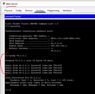

Server should ping its gateway:
