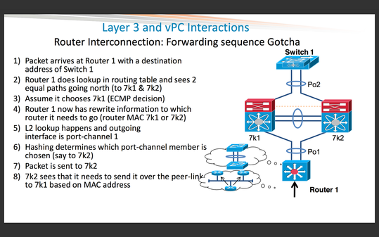

If there is no L3 then check the STP block port in both side of NSK peer.
There's no possible STP block port, are orphan port and there's no port in BLK status.
I try with a test lab soon, and follow up with the results
OK, can you check if vPC port member is suspend in one Nexus Peer.
Note:- when do LAB try config L2 connection between two Peer carry the VLAN of Server instead of config it as orphan.
CCIE DC why we must not config orphan with Host not attach to both NSK or Host use primary/standby link to both NSK.
https://ccierants.blogspot.com/2013/07/ccie-dc-two-advanced-vpc-concepts.html
