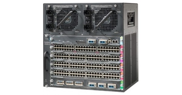

07-19-2021 07:52 AM
-> Gi8/0/48 either means slot-8/module-0/port-48 or member-8/module-0/port-48
Giuseppe Larosa uses the term linecards where i mentioned slots
If this is a switchmodel that used linecards Gi8/0/48 refers to linecard 8 port-48
similar like this image
