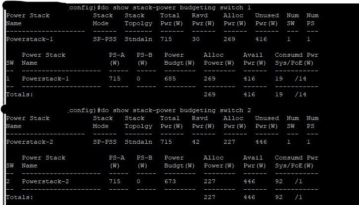

Yes actually I have just stacked them by using stack cables(picture attached)
only for many months but not stacked their power(not used any stack power cables) so then why this error even occured
The following pic shows the power budgeting on switch 1, if you see allocated power in Powerstack-1 I think it's more than usual can we edit it or any other suggestion
