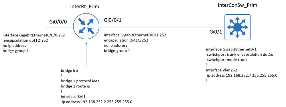

@CiscoBrownBelt wrote:
Ok after shutting down SVI252 on the INterconnSw now I can ping the .252 interface on the InterRt.
Any idea why? I would like to still use a .252 subnet on all devices or at least the INteronSw.
See below graphic - when you try and ping the Gi0/0/0 vlan 252 interface on the router from the switch, the source IP used will be the switch's vlan 252 IP Address (this will fail as you saw in your debug as you are spanning a vlan across router interfaces). When you shutdown the switch's vlan 252 interface and try the ping again it is successful because the source IP will be one of the switch's non-vlan 252 interfaces. Have a look at my previous post  on configuring bridging on the router.
hth
Andy
Ok so basically I have to use a different subnet/SVI for management preferably something that is not in on the router or internal interface and downstream on the router?
No, you can keep your vlan 252 if you configure bridging like below. Not sure if you can test this in packet tracer.
hth
Andy
