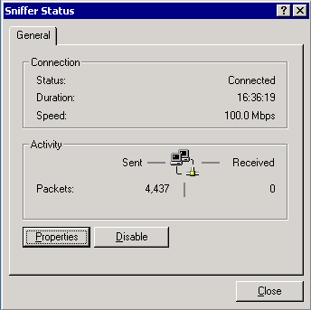

Okay I did that and I don't see traffic coming from the source switch. See attached Sniffer.png
am I missing something here?
I also didn't see the traffic!
With this schema of three switches!
But with two is okay.
Please help me.
