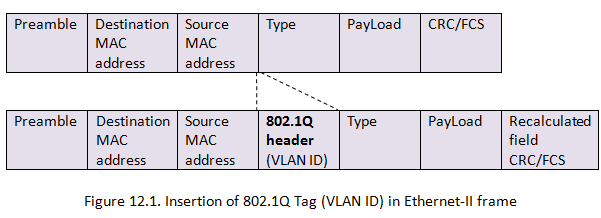

The reason is simple, when PC1 send the frame to the switch, the switch put a tag of vlan in the frame. (Native VLAN). When the switch send the frame to the PC2, this tag are stripped from frame.

What you suggest here is kind of interesting. It is quite legitimate though some might say that it was not a proper configuration. In discussing this let us start by reviewing what it means to be native vlan. Trunking using 802.1q inserts tags in the frame to identify individual vlans when a trunk will carry more than one vlan. So the switch uses tags to know whether a particular frame belongs to vlan 1 or to vlan 5 or to vlan 10. Most devices that participate in trunks will understand and process the vlan tags. But some devices (probably including the PCs in your example) do not understand tags. So the trunking protocol specifies that one vlan will be identified as the native vlan and the important thing about the native vlan is that frames in this vlan do not have tags. So the native vlan provides compatibility for devices that do not process vlan tags.

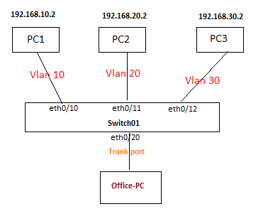

Adnan2ali
Is there away Office-PC can ping other PCs, the switch is layer 2?
I am surprised that you adopted this old discussion to ask your question and suggest that starting a new discussion would have been better. But you asked and here is my response: we do not have enough detail information about this environment to give good advice. In particular we do not know whether OfficePC interface understands trunking and we do not know on the switch trunk port which vlan is the native vlan.
If we assume that OfficePC is a standard ethernet that does not understand trunking  then any ethernet frame with a vlan tag it will not understand or respond to and any frame in the native vlan (which does not have a vlan tag) it will respond to. And if we assume that the switch config uses the default native vlan of 1 then OfficePC will not ping any pc.
