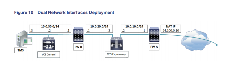

Vcs expressway edge  with two nic's
one in the dmz  and  the other in  the voice vlan .
Is it a valid configuration ?
Second thing , What type of NAT required ?
Any examples
Thanks

Yes the configuration is correct.
Static NAT should be configured for the IP address on DMZ.
The below design is validated design ( topology is below )
As you said the below nat statement is enough ?
object network obj-192.168.3.10
host 192.168.3.10
nat (DMZ,Outside) static 5.5.5.5

Configuration for a VCS-C/E is covered in the VCS Configuration Guides, look at the Basic Configuration (Control with Expressway) Deployment Guide, look at Appendix 3 (Firewall and NAT Settings) and 4 (Advanced Network Deployments).
Cisco recommend the below .
What if I have the below topology
Your drawing looks fine, but you need to configure NIC2 so the E knows the NAT configuration (it embeds the public address in the SIP/H.323 messaging), and also you need to set routes. NIC2 should be your default route, but set static route(s) for your internal traffic to use NIC1. Refer to the documents that Patrick mentioned, it's all in there.
