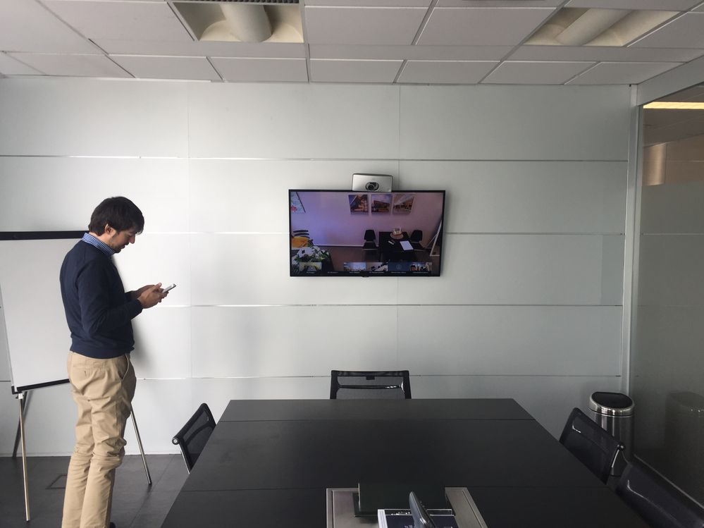

From some weeks ago we detect in almost all our videoconference SX10 systems that we have echo and is impossible to make a conference without muting one of the participants since the other is speaking. Sometimes the conference works perfect and after xx time the Echo appears. Is happening with deferent devices we have 28 - Cisco TelePresence SX10 devices in diferent locations in europe and in all we have the same version and configuration:
Product: Cisco TelePresence SX10
Software version: ce 9.2.1 360d0bf 2017-11-10
I put photos with the conference and audio configuration.
   In all the SX10 devices we have the same error:
We have the same TV that is conected with HDMI to the SX10 camara fixed on the wall and all the tv´s are in gaming mode. In the past we don’t have this issues (we have the oldes software version).            I upgrate some device to the last software version (ce 9.2.4 4de75bc 2018-02-20  ) but same result. What we can do

I've seen this problem, generally caused when the SX10 is connected to a consumer grade TV as opposed to a commercial grade monitor. Is that the case here? TV's like that don't have the processing power of a better monitor and as a result have a bit of delay between the signal coming in from the SX10 and how long it takes to see/hear on the display. You can try a sound bar on one and see if it solves the problem, or since you said it worked with older hardware you might want to just go back to that version. You also can open a ticket with TAC and see if they have any suggestions.
Hope this helps.
We have Samsung and LG TV´s 65´´ located in meeting rooms
Not clear on whether those are consumer or commercial grade, but with two brands I'm guessing you have something else going on. What are you using for a bridge (MCU) on these calls? Since it doesn't always occur, are you sure it isn't being caused by someone connecting a laptop or phone into the same meeting while in the same room?
Ever since Webex CMR came out I can't count how many times I've seen someone sit at a table in a room that's dialed into Webex CMR bridge and yet they still connect their laptop, which creates an audio loop.
