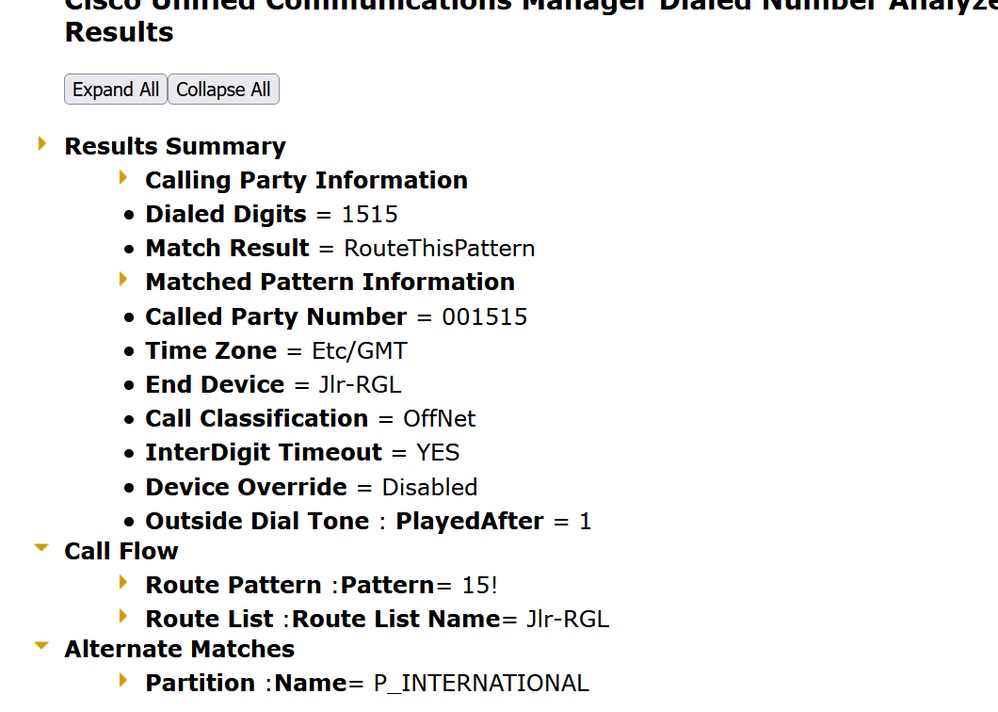

First case, both RP 15XX and 15! are in same partition internal. and see DNA result. It match 15XX which is the closest match.
Case two, they are in different partition. 15XX in international partition and 15! in internal partition.  CSS international has first partition  internal and last partition international. In this case when you dial 1515 it match with the 15! even though its not the closet match.
I changed the Partition order and made the international on top. so now it match 15XX instead of 15! RP.

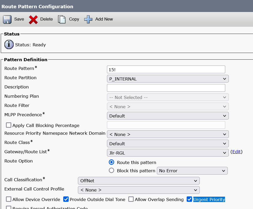

case three, both are in same parition. But for 15! i have checked URGENT PRIORITY. in this case, instead of 15XX it match with the 15! RP.

Both routes pattern are in the "none" partition. And no urgent priority checked.  My question is clear: why the route pattern 15! is matched first even if it has unlimited matched digit strings?
  First two digit  15, it match with 15! RP because its exact match than 1[3-5]. .
Instead of using 1[3-5]XX if i use 15XX, if i dial 1515  it match with RP 15XX. Now 15XX is closest match than 15!.

If two RP configured on system for same pattern then system works based on below criteria
1: Check Urgent priority on RP
2: Check Calling Party CSS: So CSS contain prioritise list of partition, it will check which RP Partition added first on calling Party line css if two pattern match.
3: Based on Best RP Match
So you need to verify above based on your configuration.

Because it is a better match as the first two digits in the dialled number 1515 is explicitly matched with the 15! route pattern. Whereas with 1[3-5]XX it match the 1 explicitly, but then it can match more than one digit, namely 3, 4 or 5. This causes the first route pattern to be the better match by the route logic.
