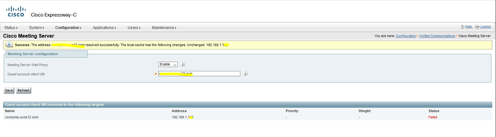

Cisco Meeting Server status showing failed in Expressway-C
sanjay.kumar
Hi
Getting Below Error On Expressway-C
any idea why getting the status failed
Thanks
Sanjay

A few points to check
  • The expressway servers should have the root CA that signed the CMS certificate
  • The expressway E server certificate should contain the guest URI in its SAN entry
  • can you confirm that you are able to open the guest URI internally?
also, please provide the CMS and expressway servers versions
