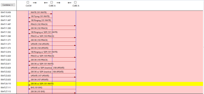

Occasionally I have outbound calls which fail due to lack of ACK from CUCM on a 200 OK from CUBE. The flow goes as shown in the diagram below. Normally a network issue is causing such problems. Here however there is nothing between the CUCM and the CUBE. I am about to open a case with TAC, any suggestions prior that are welcome.

How does the flow look like in perspective of the CUCM?
Does CUCM ever get an ACK from the calling device?
No, the calling device does not send an ACK. The calling device is not a physical phone or a softphone. It is a CTI port, more specifically an RCP port. We have this setup to allow work from home (incoming on a Service Line----->UCCE---->CUCM (LCP port)------->CUCM (RCP Port)------>Agent's mobile phone.

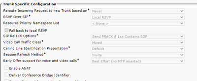

I had to do Send PRACK and early offers on SDP because I would get similar situations like yours.
Here is what I have in one of the sip trunks.
My SIP trunk config is the same

My missing ACK is between CUBE and CUCM, that is all internal. Provider does not have much to do here. Apart from that the outgoing call flow will be: Endpoint---->CUCM---->CUBE---->CUSP----SIP Provider. After CUSP all is a black box to me.
