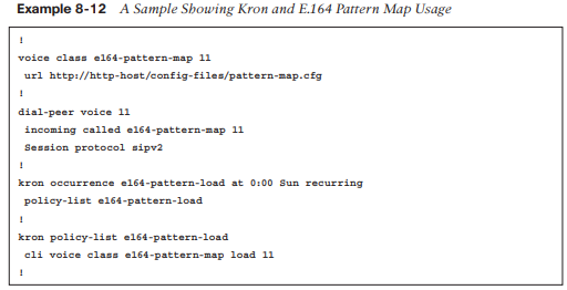

For the refresh of the file you can use the kron capability in IOS to set it up to periodically perform the reload of the file at the url.
This example is from the CLACCM book.
